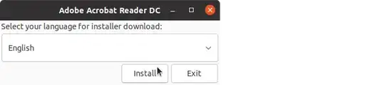

  4. Select a language for installer download from the dropdown menu and click the Install button in the Adobe Acrobat Reader DC window. A small progress bar window will open to show the progress of downloading Adobe Acrobat Reader DC.

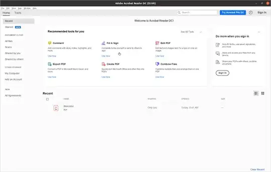

  5. Launch Adobe Acrobat Reader DC. A red Adobe Reader icon will appear in the Dock when Adobe Acrobat Reader DC is open.
    acrordrdc

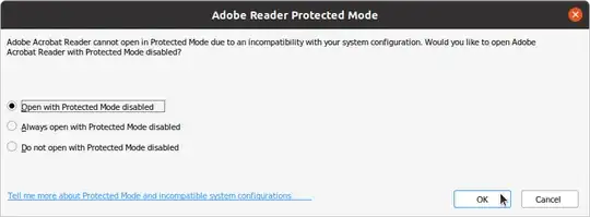

  6. You may need to disable Protected Mode to open Adobe Acrobat Reader DC.

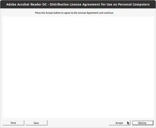

  7. Press the accept button to accept the Adobe Acrobat Reader DC License Agreement and continue.
  8. You can auto-fill forms if you sign in to Adobe Acrobat Reader DC as shown in the upper right corner of the below screenshot.

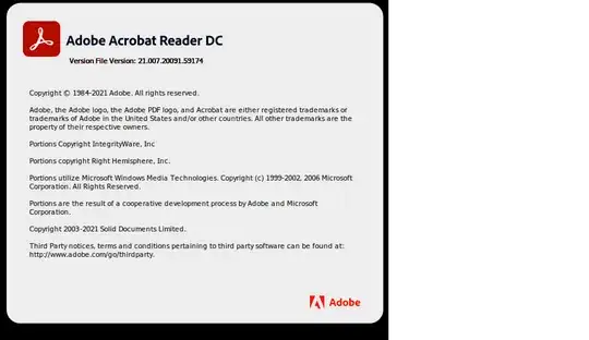

  9. My current version of Adobe Acrobat Reader DC is 21.007.20091.59174, the latest version. You may have to reinstall the acrordrdc snap package if you upgrade your Ubuntu release to ensure that it is compatible with your upgraded operating system.
