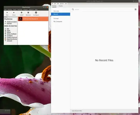

click on "install a program" and wait for the list to get refreshed. Search for Acrobat as soon as it is finished:
playonlinux with acrobat reader.
You will be guided through the installation. It will take some time but after that you can run Acrobat DC via wine.

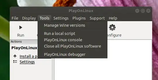

Download the install-script manually under the section "new sourcecode" revision 2017-11-20 11-38 published on 20 November 2017. Save it in your Downloads directory i.e. under acrobat_new.sh. Then install from the menu using "run local script":
local script menu
execute local script
Acrobat DC will install successfully:
