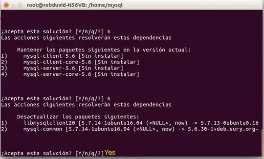

I had the same problem, and I tried a lot of options. And I had a lot of problems with libdbd-mysql-perl; the system said that was not going to install that library.
So I thought to install it with the Aptitude that install a package and correct all the dependencies.
If you don't have aptitude you can get it like this:sudo apt-get install aptitude
First all you need to uninstall your existing mysql. Next you need to install the package that you want.
sudo aptitude install mysql-server-5.6
The aptitude give you a lot of option, what to do. The first options is to keep the actual package. So press (N)o until you find the option that say to downgrade the next packages:
libmysqlclient20 [5.7.14-1ubuntu16.04 (<NULL>, now) -> 5.7.13-0ubuntu0.16
mysql-common [5.7.14-1ubuntu16.04 (<NULL>, now) -> 5.6.30-1+deb.sury.org
then press (Y)es and the aptitude is going to install the mysql-server-5.6. Here's the option that you should accept:
If after that the system cannot connect to mysql server you need to restart your computer.
