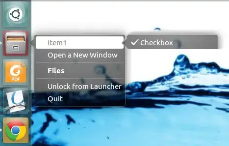

What do I mean by submenu (made in gimp): enter image description here
Why do I think this is even possible? An option called Dbusmenu.MENUITEM_PROP_CHILD_DISPLAY, reads "have the subitems displayed as a submenu" sounds awfully close to what I want to do, but I've failed to archive that. The above snippet adds a dbus-item to another one, and sets the submenu-property (on the Nemo/Nautilus launcher)
(Bonus: I haven't found anything to make check_item_activated distinguish rightclick, leftclick and middle-mouse-button, but prove me wrong)
