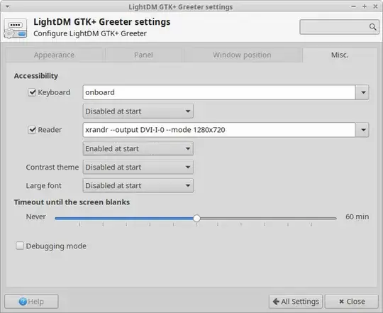

Valinux
This is the simplest solution. Works on Xubuntu 20.40.
  • Get your monitor name and resolution from xrandr -q.
  • Go to Settings > LightDM Greeter > Misc.
  • Enable Reader checkbox and enter xrandr --output DVI-I-0 --mode 1280x720.
  • Enable at start.
screenshot
