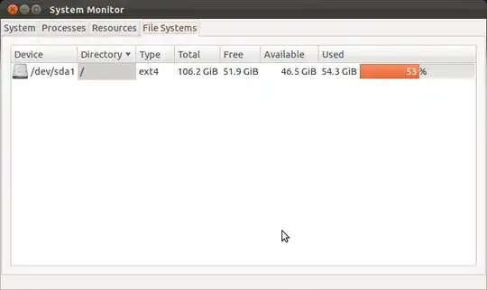

Open System Monitor from Dash and select the Filesystems tab.
Or alternatively open a Terminal and type:
df -h

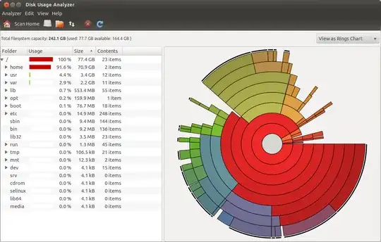

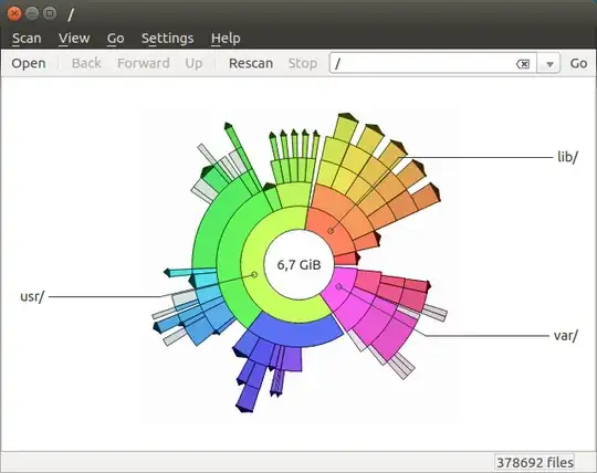

You can use baobab, or similar tools such as kdirstat or filelight, to see what files are using up your disk space.
Baobab is also called Disk Usage Analyzer on Ubuntu.
Here's a sample screenshot of baobab:
baobab
Below is a sample screenshot of filelight:
filelight

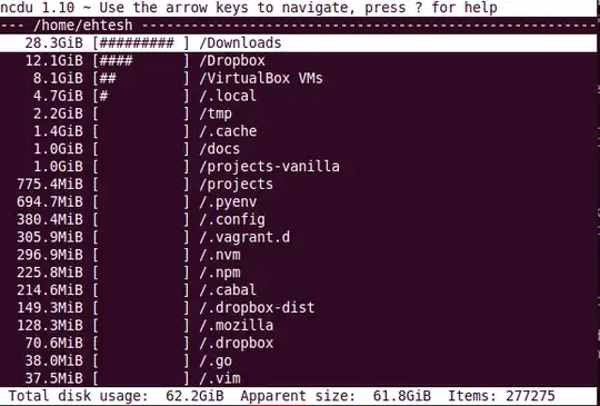

For a command line option, I prefer to use ncdu:
ncdu
You can drill into sub-folders to get total relative disk usage on the sub-folders. It's turtles all the way down. More nifty than du -sh on remote machines.

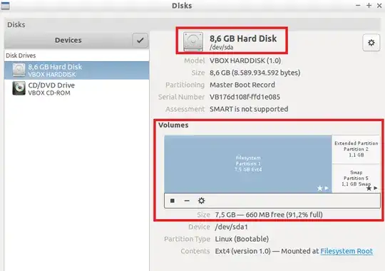

In lubuntu you can do as follows:
1- Start Button > Accessories > Disks
2- Start Button > Preferences > Disks

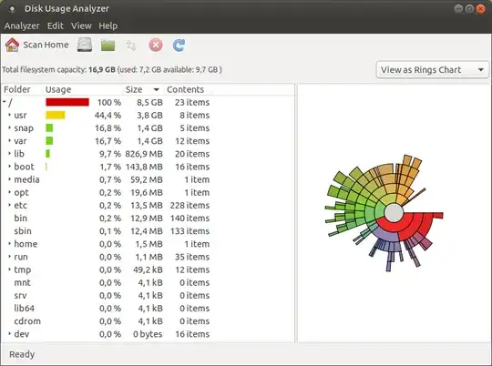

If you use Ubuntu with MATE DE (Ubuntu MATE) you can use MATE Disk Usage Analyzer:
  • its icon is located in Applications->System Tools
  • it is a part of mate-utils package
  • its executable is named mate-disk-usage-analyzer
  • its screenshot is presented below:
    even on latest 18.04 LTS it looks traditionally nice.
