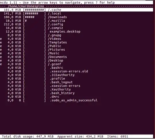

I used ncdu command and I get it
ncdu

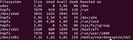

df -h
df -h

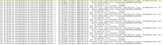

syslog file
syslog

Then, I opened the file syslog to see what is the issue which fill my syslog, and I find this issue:
PCIe Bus Error, id=00e8
