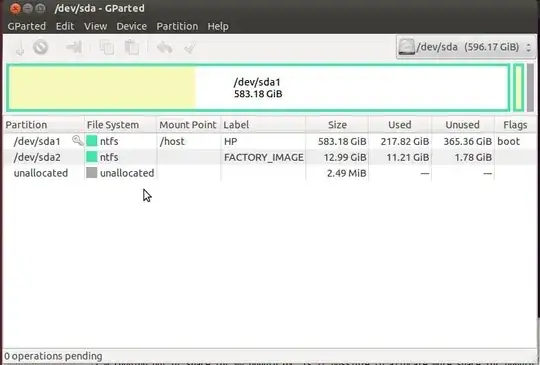

I am using GParted to view my partitions, but Ubuntu does not seem to pop up on it anywhere:
Screenshot of GParted

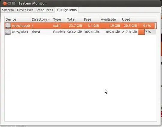

Disk space using System Monitor

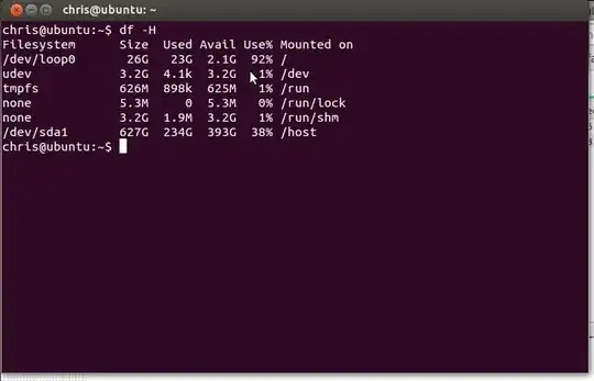

Disk space using System Monitor df -H

Here's your problem. Your hard drive (sda) partition has tons of space (sda1), but it looks like you installed Ubuntu from within windows using WUBI, so Ubuntu doesn't have it's own partition and uses a big file on your Windows partition (sda1) as a /host.
