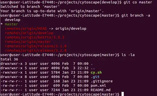

217
Ubuntu: Show your branch name on your terminal
Add these lines in your ~/.bashrc file
# Show git branch name
force_color_prompt=yes
color_prompt=yes
parse_git_branch() {
 git branch 2> /dev/null | sed -e '/^[^*]/d' -e 's/* \(.*\)/(\1)/'
if [ "$color_prompt" = yes ]; then
 PS1='${debian_chroot:+($debian_chroot)}\[\033[01;32m\]\u@\h\[\033[00m\]:\[\033[01;34m\]\w\[\033[01;31m\]$(parse_git_branch)\[\033[00m\]\$ '
else
 PS1='${debian_chroot:+($debian_chroot)}\u@\h:\w$(parse_git_branch)\$ '
fi
unset color_prompt force_color_prompt
Reload the .bashrc file with this command:
$ source ~/.bashrc

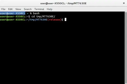

For now, I followed this https://gist.github.com/eliotsykes/47516b877f5a4f7cd52f and working, liking it so far, though I'm planning to customize it further.
In Terminal
mkdir ~/.bash
Copy the raw git-prompt.sh file from git contrib in to the ~/.bash directory: https://github.com/git/git/blob/master/contrib/completion/git-prompt.sh
Inside ~/.bashrc or ~/.bash_profile (choose the file where you normally put any bash customizations/setup), add the lines:
source ~/.bash/git-prompt.sh # Show git branch name at command prompt
export GIT_PS1_SHOWCOLORHINTS=true # Option for git-prompt.sh to show branch name in color
# Terminal Prompt:
# Include git branch, use PROMPT_COMMAND (not PS1) to get color output (see git-prompt.sh for more)
export PROMPT_COMMAND='__git_ps1 "\w" "\n\\\$ "' # Git branch (relies on git-prompt.sh)
As long as you're inside a git repo, your Bash prompt should now show the current git branch in color signifying if its got uncommitted changes.

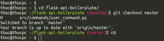

Quick hack:
  1. Adding this to ~/.bashrc:
export PS1="\u@\h \[\e[32m\]\w \[\e[91m\]\$(parse_git_branch)\[\e[00m\]$ "
  1. Restart the terminal, or source ~/.bashrc:
More detail: https://medium.com/@thucnc/how-to-show-current-git-branch-with-colors-in-bash-prompt-380d05a24745

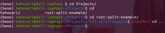

In my case I didn't overwrite the PS1 variable because I had to preserve the prepended environment that is added by anaconda package, that is the (base) in the image bellow. I use Ubuntu 20.04, and all I wanted is to append the branch at the end, thanks to @thucnguyen as my solution is based on his one:
terminal screenshot
  git branch 2> /dev/null | sed -e '/^[^*]/d' -e 's/* \(.*\)/(\1) /'
export PS1="$PS1\[\e[91m\]\$(parse_git_branch)\[\e[00m\]"
