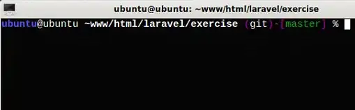

My friend has installed some kind of a shell for terminal and on that machine i can see in which branch I am at the moment. It looks like this:
And now i want to install that on another machine but i don't know the name of it. I hope someone will recognize it from the screenshot.

It's actually a zsh shell
install it with apt-get
sudo apt-get install zsh
download the theme
wget -O ~/.zshrc https://raw.githubusercontent.com/grml/grml-etc-core/master/etc/zsh/zshrc
change the default shell (please note that you will lose your aliases with this)
chsh -s /bin/zsh
update for aliases
if you have aliases in a separate file in your home/<user_name> folder then append this to the end of the .zshrc file in your home/<user_name> folder
if [ -f ~/.aliases_file ]; then
     . ~/.aliases_file
fi
