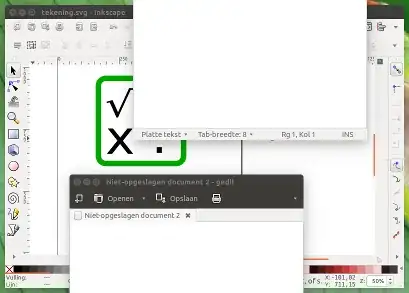

Using shutter and wmctrl, an edited version of this script does pretty much exactly what you describe: it takes a screenshot of the area, a specific window covers on your screen, no matter if and how the window is (partially) below other windows.
The marge around the window, to be included in the screenshot, is arbitrary; set it to zero if you like.
In practice
  • I have an Inkscape window on my screen, with id 0x0520000e, partially covered by a few gedit windows.
  • I run the script with the window id and the marge (in px) around the window as arguments:
    python3 <script> 0x0520000e 10 10 10 10
    (where 10 10 10 10 is the marge in px around the window on the left/right/top/bottom. Set to 0 to have no marge in the image)
    The result:
