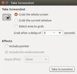

I'm trying to take a screenshot of the the dash, HUD and application menu (separately). But I am having difficulty getting a screenshot: the dash or HUD disappears before I can take it. I would appreciate advice.

Launch the Screenshot application and check the 'Grab the whole screen option. More importantly, set a non-zero value (say 5 seconds) for the 'Grab after a delay of ...' option.
Then press the 'Take Screenshot' button and make sure the dash/HUD etc. is enabled when the screenshot is set to be captured (current time + set delay).
