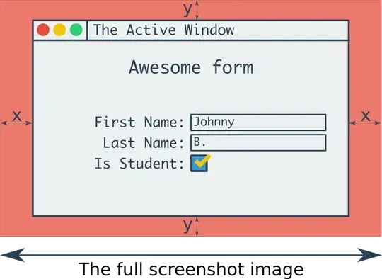

I need a tool that will do the following: selecting a window, will make a screenshot of that window with a x padding, like in the following image:
So, in most of the cases x will be equal with y, but sometimes I need different distances.
How to make such a screenshot, automatically? I tried with Shutter, but I couldn't find such a setting there. However, it supports plugins. So a plugin could be to crop the window this way.

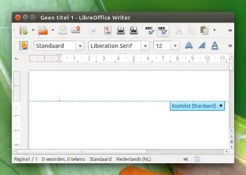

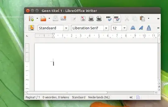

If you make the script below available under a key combination (explanation further below), a window will pop up, allowing you to set the margins of your screenshot on the left, right, top and bottom, separated by a space:
result:
or:
result:
etc.
I set the default to 30 px, but you can set any default value (see below).
