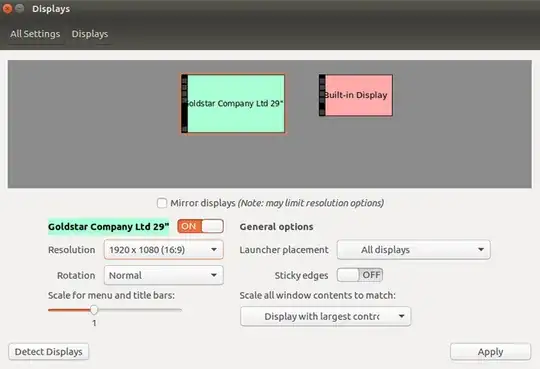

In settings, I have only full-hd resolution 1920x1080.
default settings with 1920x1080 screenshot
Settings is not has 2560x1080 resolution.

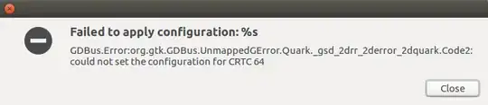

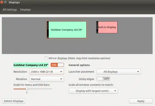

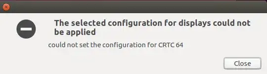

In the settings appears resolution for 2560x1080, and when I trying set this resolution, the image is becoming broken and appearing two errors.
New resolution =>
new resolution screenshot
First Error =>
Error screenshot
Second Error =>
Error screenshot

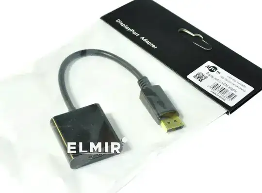

Also, I tried to connect via ATcom adapter, and I didn't get the result. Resolution left to 1920x1080.
atcom screenshot
