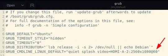

  1. Update resolution using sudo gedit /etc/default/grub and change the GRUB_CMDLINE_LINUX_DEFAULT to the following. enter image description here Original was: GRUB_CMDLINE_LINUX_DEFAULT="quiet splash acpi_backlight=vendor". Then commit to that change with sudo update-grub

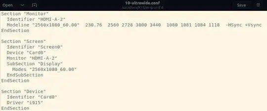

  3. Using a script created in /usr/share/X11/xorg.conf.d enter image description here

  1. Method 1 and 2 was: custom-screen-resolution-ubuntu-wayland
  2. Method 3 was: How do I configure Ubuntu for a 21:9 screen?

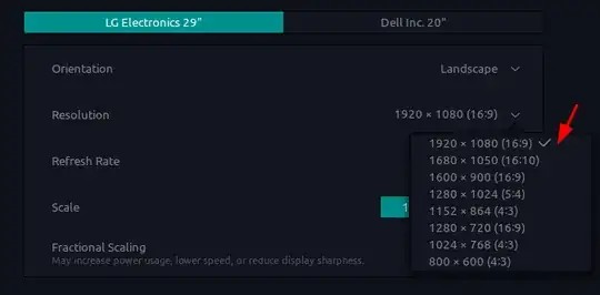

What failed
  1. Apparently using grub.
You can’t set custom resolution higher than the maximum one in Display settings
  1. The script was intended to add those settings upon boot from my understanding, but nothing is happening.
