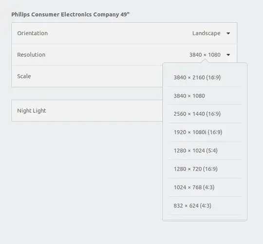

Monitor runs in 3840x1080 which isn't native for it and everything is super blurry. Resolution selector looks like this:
resolution selector

According to Intel only HDMI 1.4 at a max of 4096x2304 at 30Hz is possible. And according to Philips your monitor requires HDMI 2.0 or DisplayPort 1.4 to get full resolution.
Thus, you will need to upgrade to a GPU capable of HDMI 2.0 or DisplayPort 1.4, along with a cable to match the specification. Then you should be able to get the native resolution.
