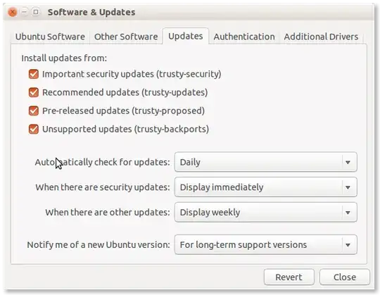

Notice
These bugs hits ubuntu trusty 14.04 with Pre-released updates : trusty-proposed Software Updates properties
Where last update of libnl packages from version 3.2.21-1 to 3.2.21-1ubuntu1 introduced a regression causing network-manager to crash
There isn't yet any upgrade on network-manager in trusty-proposed

In addition to the given solution I want to give a general advice.
Turn off the "proposed" repository
It is not supposed to be turned on. This "problem" affected only those users who turned on the proposed repository and installed a broken package.
This repository contains testing packages that are not recommended to install unless you want to test some specific packages.
Keep "proposed" off if you do not want this kind of surprises.
