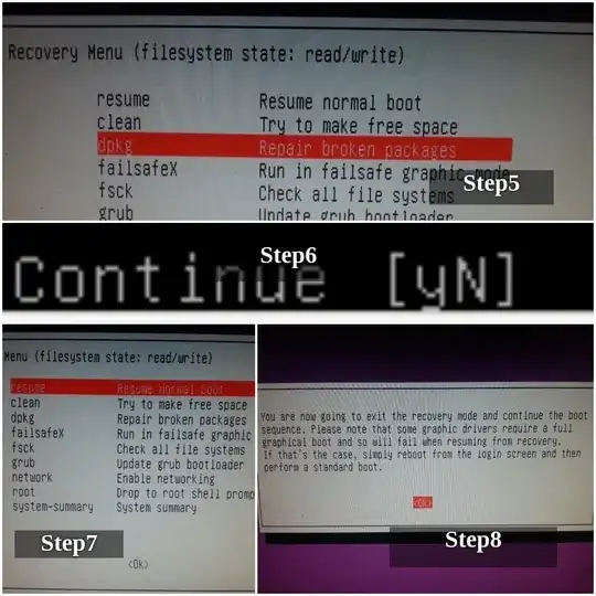

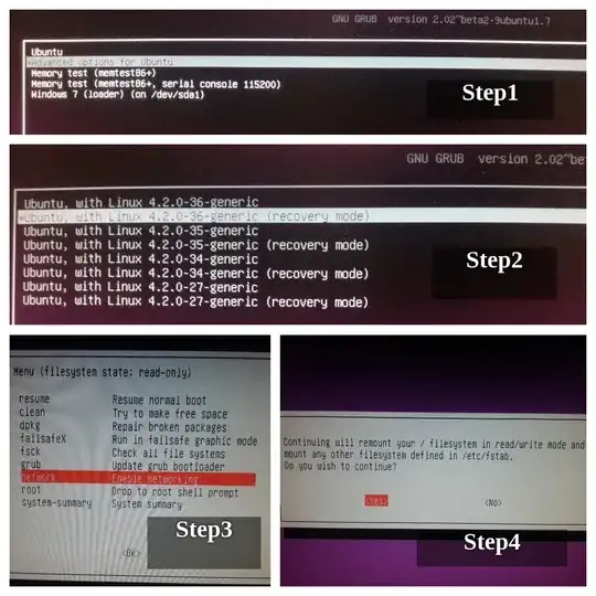

Use Ubuntu's built in recovery mode to upgrade Network Manager.
Step 1
Use the down-arrow key to select Advanced options for Ubuntu and press Enter
Step 2
Use down-arrow key to select the latest Linux kernel with Recovery Mode and press Enter
I used Ubuntu, with Linux 4.2.0-36-generic (recovery mode)
Step3
Use down-arrow key to select network Enable Networking and press Enter
Step 4
Press Enter for OK to remount the file system
Step 1 to 4 screenshots
Step 5
Use the down-arrow key to select dpkg Repair Broken packages and press Enter
Step 6
It will ask to download the latest Network Manager with Continue [Y/n]. Input letter y for "yes" and press Enter. When all operations have finished it will say
Finished. Please press Enter
So press Enter again.
Step 7
Select resume Resume normal boot and press Enter
Step 8
Press Enter and continue to boot. At the login screen DO NOT log in instead do a NORMAL restart (click shutdown icon at the top right area of the screen).
After the PC restarts then log in.
Network connections were back when I did these steps.
Step 5 to 8 screenshots
