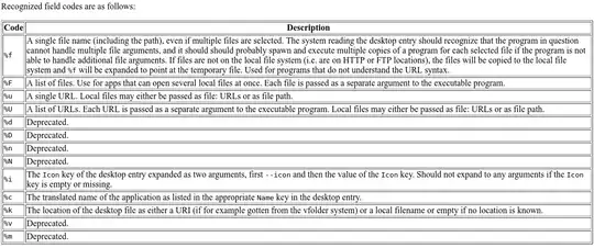

Servicemenus are defined using .desktop files. Desktop Entry Specification: https://standards.freedesktop.org/desktop-entry-spec/latest/
Image: Desktop Entry Specification has the meaning of the keys/codes Image: Sample of the Desktop Entry Specification keys/codes

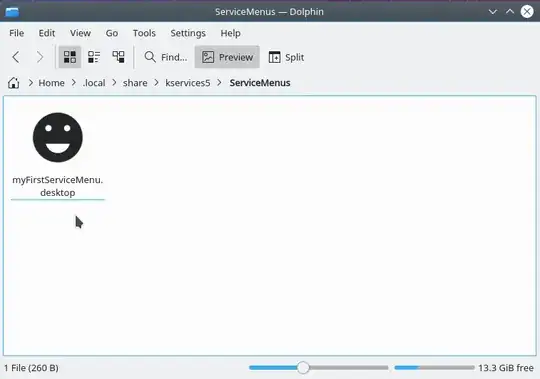

An example - simple servicemenu with file path:
Making: $HOME/.local/share/kservices5/ServiceMenus/myFirstServiceMenu.desktop
If the directory doesn't exist the user can make it !
[Desktop Entry]
Type=Service
Icon=smiley-shape
X-KDE-ServiceTypes=KonqPopupMenu/Plugin
MimeType=all/allfiles;
Actions=helloWorld;
Encoding=UTF-8
[Desktop Action helloWorld] Name=Hello with path information Icon=smiley-shape Exec=kdialog --msgbox "Path is %f"
Image: a servicemenu at the right place. Image: a servicemenu at the right place.
Closing all Dolphin windows and starting a new one. When right clicking a file:
