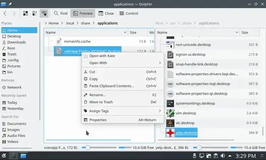

This is an image of Dolphin's context menu before creating the service menu:
Dolphin context menu before creating the service menu

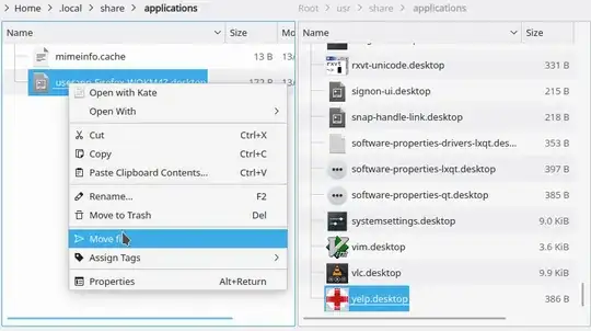

In the following screenshot taken after creating the service menu you'll see an additional entry, Move file:
Note the Move file entry

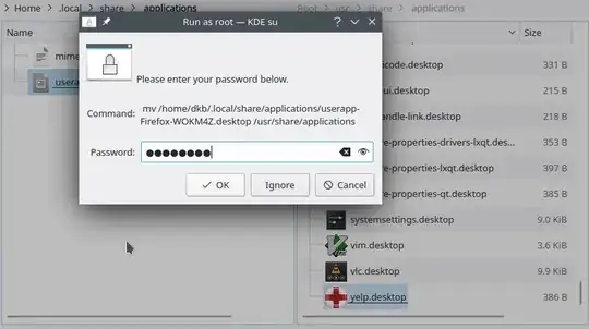

Clicking on Move file will prompt you for your password because you want to move a file into /usr/share/applications.
Password required

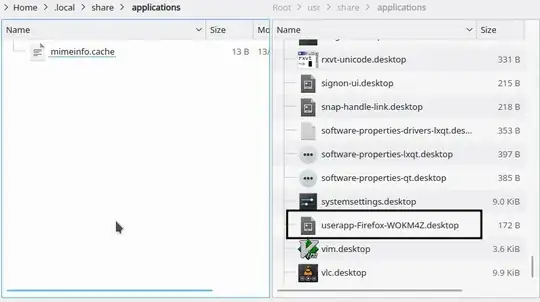

After providing your password, the selected file will be moved to /usr/share/applications:
File is now removed from its original location and is now in */usr/share/applications*

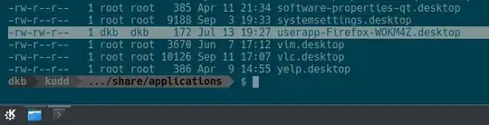

Note that the owner isn't the same as .desktop files already there. You'll need to fix that however you choose:
File ownership differs
