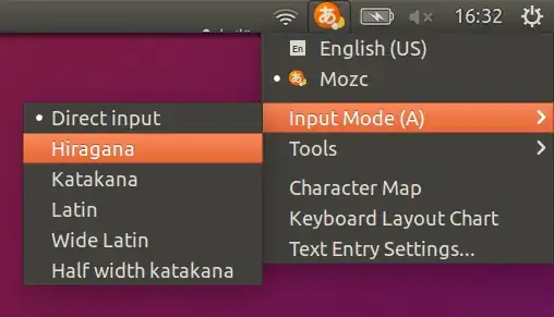

Every time I restart my computer and want to type in Japanese, pressing Super+Space is not enough, I also have to select Hiragana in Mozc's menu:
Ubuntu Mozc IBus direct input hiragana
It gets me everytime. It is a bit like if your car's brake acted as an accelerator the first time you use it each day. Everyday the first time you brake you have to remember to push a lever. In other words: Incredibly annoying and a sure way to get accidents.

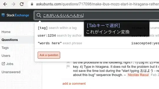

[edit] inline conversion looks like inline_conv
