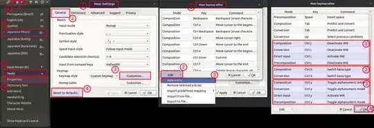

Steps to create the Japanese Mozc key bindings, to switch the input modes:
  1. Open a text editor (e.g. Gedit).
  2. Click on Gnome Status menu (Gnome's top-left bar) > IBus menu (i.e. keyboard/input language selector) > Select Japanese Mozc input method.
  3. Again, click on Gnome Status Menu > IBuz > tools > Properties > Mozc Settings window.
  4. From Keymap style section > click on customize button (first one).
  5. Create new entries with your personal shortcuts to duplicate the japanese keys binding: hankaku/zenhankaku, muhenkan, eisu.
  6. Run ibus-daemon -drx to reload and take configurations into effect if necessary.
  7. If messed things up, click on reset to defaults button from Mozc Settings window.
That's all!
Graphical abstract
Steps to create the key bindings to toggle Japanese syllabaries input mode.

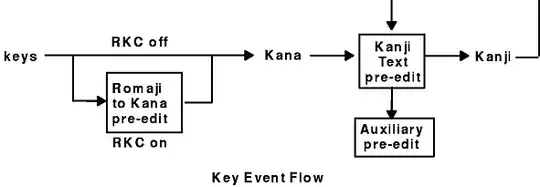

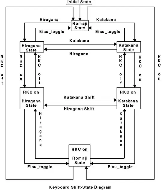

Our computer can receive inputs from many talked/typed languages and hardware (i.e. different keyboards and layouts). So it needs to organize the configurations and permit to the user choice between different languages. For example, a user can type one document in Italian AND English languages, at alternating times. So the software needs to show the user a way to change the language to be inputted.
The Linux user have 2 layers of software to configure the input method by keyboard:
  • Input Method Framework (IMF): a class of software that organize the inputs (from keyboard, mouse etc), send to the correct destination (software, systems etc), and configure them.
  • Input Method Editor/Engine (IME): a class of software that receives the inputted characters (from a keyboard), translate them to the desired input (i.e. idiom, language) and, send them to the Input Method Framework (IMF) to handle them. Basically, we have: from keyboard > (typed/inputted keys) > IME (receives and translate them) > (translated inputted keys) > IMF (handle translated inputted keys to destinations).
For the Linux user, an example o IMF is IBus; an a example of IME is MOZC. The first one will switch between all installed IMEs and switch between all idioms/languages installed too. The second one, if selected, will send to the IMF only Japanese keys, even if you typed in a non-Japanese keyboard. About Japanese IMEs, you can read more about here, and visualize the states/events in these diagrams:

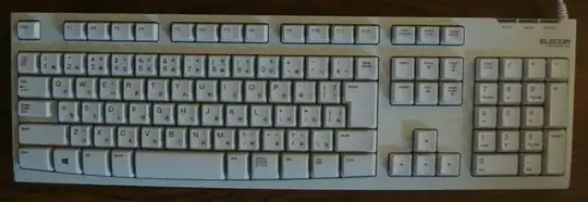

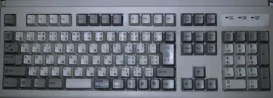

Japanese keyboard
Layout
The Japanese keyboard layout (キーボード) is established by Japanese International Standard (JIS). First of all, let's contemplate the Japanese keyboard! Watch an open box video. You can see the vector draw bellow, showing clearly the Japanese keys:
Finally, some real pictures bellow:
Japanese keyboard layout 1 Japanese keyboard layout 2
Try to identify each key, slowly.
We have:
  • Roman letter (QWERTY).
  • Hiragana symbols.
  • Small hiragana symbols.
  • Han-dakuten symbols (maru, tenten).
  • Arithmetic symbols.
  • Capslock, shift, super, alt, tab, Ctrl, Enter, Backspace.
  • Punctuation with Japanese style (period, quotes etc).
  • and some special keys with Japanese words:
    • muhenkan 無変換: don't convert kana to kanji.
    • henkan 変換: convert kana to kanji.
    • hiragana/Katakana/romaji カタカナ / ひらがな / ローマ字:
    • hankaku/zenkaku 半角 / 全角: switch between half-width or full-width
    • kanji 半角 / 全角 / 漢字: switch between kanji or English characters.
    • eisū 英数: switch to alphanumeric characters.
You can have more description of these specific keys here. And read about the text frequency of hiragana, katakana e kanji and here.

See the screenshots from before to get a hint of where the MOZC keymap is. To edit/read these keys on your Mozc:
  1. Open a text editor (e.g. Gedit) and stay with it in foreground.
  2. Select Mozc input mode: Hold Super and press Space as many times as to select Mozc option. Or click on: IBus (at GNOME Status Menu) > Japanese (Mozc).
  3. To read/edit these Japanese key bindings, click on: IBus (at GNOME Status Menu) > Tools > Properties.
  4. After Mozc Setting window popped up, click on: General tab > Keymap section (at bottom) > Keymap Style customize button (first one).
  5. After Mozc keymap editor window popped up, click on: Scroll up and down to memorize and edit the Japanese keymap (bindings).
  6. Probably, you may will toggle between all Mozc's input modes (hiragana, katakana, romaji etc) if you duplicate and edit these binding keys for your chosen shortcuts. Basically, to switch between syllabaries using MOZC, you need to memorize/edit/press:

So, we need to create new shortcuts similar with these, like bellow (these are my shortcut sugestions):
Composition Ctrl j  IMEOff
Conversion  Ctrl j  IMEOff
DirectInput Ctrl j  IMEOn
Precomposition  Ctrl j  IMEOff
Composition Ctrl b  SwitchKanaType
Conversion  Ctrl b  SwitchKanaType
Composition Ctrl y  ToggleAlphanumericMode
Conversion  Ctrl y  ToggleAlphanumericMode
DirectInput Ctrl y  IMEOn
Precomposition  Ctrl y  ToggleAlphanumericMode
If you are interested, you can read MOZC's romaji-hiragana conversion table.
  1. If you mess the things, click on reset to defauts button at Mozc setting window (opened in Step 3).

  2. Again at GNOME Status Menu, select Tools > Properties.
  3. After Mozc Setting window popped up, click on: General tab > Keymap section (at bottom) > Keymap Style customize button (first one).
  4. And after Mozc keymap editor window popped up, click on: Edit button menu (at bottom) > click import from file... or export from file.... With that you can save (export) your keymap editions. And you can to insert a new keymap edited by importing it.
That's all!
