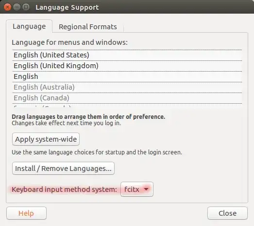

After install open System preference > Language
IME
Please change this into your choice iBus/fcitx/uim and restart computer or your session.

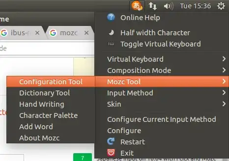

First activate the Mozc then, click on Mozc Icon on the menu bar.
Mozc Tool > Configuration Tools.
Menu
Like this.

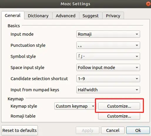

Mozc Settings
The Mozc Settings Window should appear and click on the Customize button.

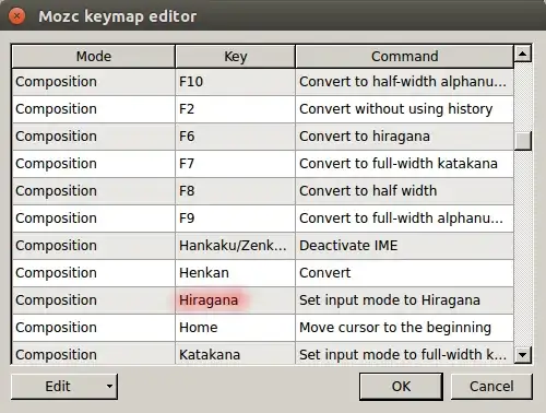

Keymap Window
When you click on the Command column, you can select actions for a hotkey, choose set input mode to Hiragana. Then you can assign your favourite hotkey, this example is for the Hiragana key that most of US keyboard layout doesn't have it. You may need to restart your computer after this setting.
