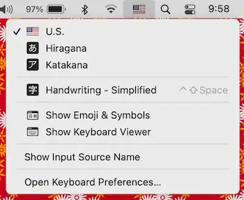

On Macs, you can set up your language keyboard to toggle between various Japanese input methods and keyboards in the same "set":
In my case, with this, I can hit the "switch keyboard layout" section and toggle between a US, French, then "US/Hiragana IME"/"US/Katanana IME", etc.
