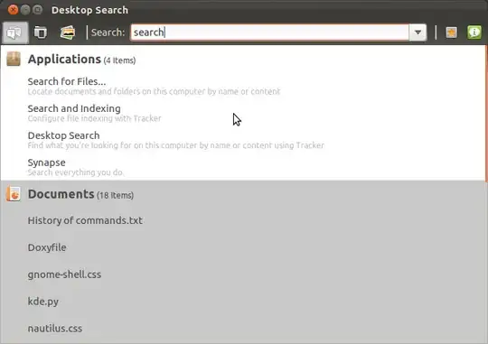

You can try tracker-search Install tracker-search
It is available in the Software Center.
To install it, run the following command in a terminal:
sudo apt-get install tracker-gui
After installing it, search for Desktop Search in the dash and open it. You can then search for the files and folders in the search bar.

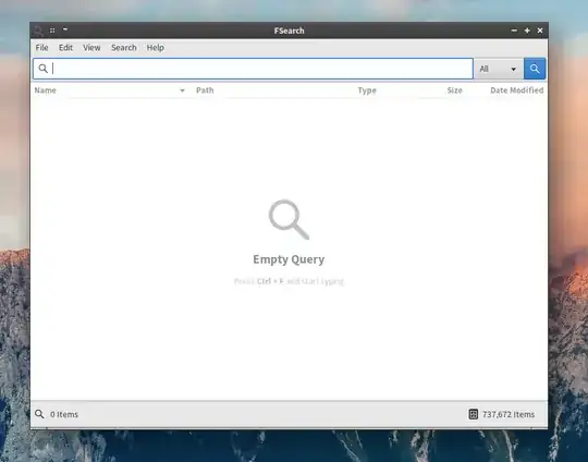

An app called FSearch could help with this.
FSearch is a fast file search utility for GNU/Linux operating systems, inspired by Everything Search Engine. It's written in C and based on GTK+3.
It has regex support and instant results.
sudo add-apt-repository ppa:christian-boxdoerfer/fsearch-daily
sudo apt update
sudo apt install fsearch

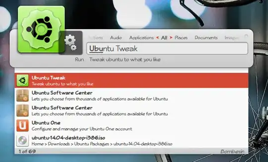

Install synapse from the software center or via the terminal using
sudo apt-get install synapse
Synapse is a semantic launcher written in Vala that you can use to start applications as well as find and access relevant documents and files by making use of the Zeitgeist engine.
It will index all your files - images, music, video, documents, applications, folders you visit, etc and you can launch them from there.
To activate just use ctrl + space keys and just type your search terms. Scroll the results using the up and down keys and browse the different categories using the right and left. Once you find your result, press enter to launch.
See screenshot below after I typed 'ubu':

Yes, FSearch is an Ubuntu equivalent of Everythings in Windows.
FSearch also could search Windows files (fat32, NTFS formats).
Installation:
sudo apt-get update && sudo apt install fsearch-trunk

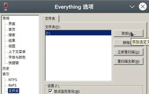

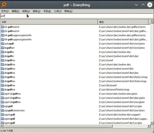

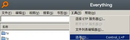

You can use wine + everything with some configrations.
  1. tool -> option
  2. set the root directionary.
Then, enjoy everything on ubuntu. :-P
