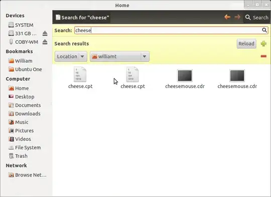

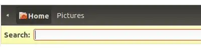

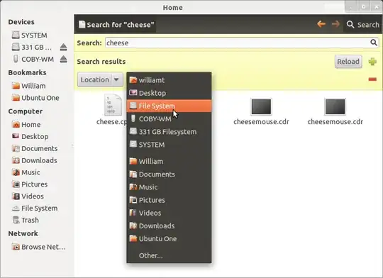

Start by clicking the "Home Folder" icon in the launcher.
In the window that opens, click "Search".
Type what you want to search for in the box, then press enter. enter image description here
Under the dropdown for location, choose your hard drive, then click reload.
The results will then be displayed. Hope that helps!

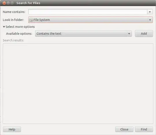

For a Desktop setup, Install "gnome-search-tool"
sudo apt-get install gnome-search-tool
Don't install this in a server, it will also install the ubuntu desktop package.
Thanks to @Rinzwind for pointing that out.
Filters inlude:
  1. Choose the folder you want to search. In this case \
  2. Contains the text - this is the file name.
  3. Date Modified - less or more than in number of days.
  4. File size - at least or at most a specified size. You can also search empty files.
  5. File owner - user, group or unrecognized owner.
  6. Regular expressions - matches regular expressions.
  7. You can choose to show hidden files, follow symbolic links or exclude other filesystems.
