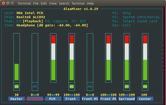

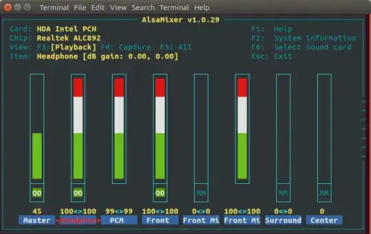

I opened alsamixer to see what happens when I plug/unplug the headphones.
Headphones in: Headphones in
Headphones out: Headphones out
With the headphones plugged in I manually changed all the settings to match the settings when the headphones are out and still didn't get any sound through the speaker.

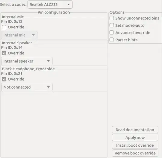

hdajackretask is a tool to reassign the function your jacks for different input, output or disabled - e g, turn your Mic jack into an extra Headphone, or why not make them both line outs and connect them to your surround receiver?
Install alsa-tools-gui
sudo apt-get update
sudo apt-get install alsa-tools-gui
Run hdajackretask Then To override one of your jacks:
  1. Select a codec
  2. Click the "Override" checkbox for that pin and select the new desired function
  3. Click "Apply now"
    Note: If the headphone jack has a built in hardware switch that re-routes the audio then you are SOL (Sorry outta luck). However, if the OS detects when a line is plugged in the headphone jack then the audio is most likely not mechanically switched.
I found that overriding both the headphones and speakers at the same time works best.
hdajackretask Screenshot to switch the headphone to speakers:

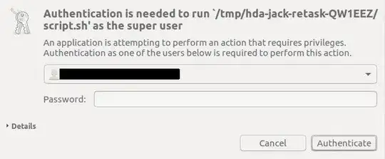

After you click "Apply now" a shell script is created to make the changes and prompts for super user password to execute. The script is also saved in /tmp which can be copied and later executed with sudo from the command line.

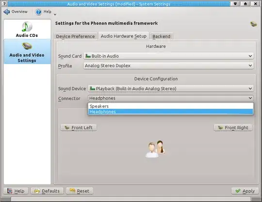

In KDE this can be done:
system settings -> multimedia -> audio and video settings -> audio hardware setup tab > select the appropriate sound card > under Connector you shall see headphones and speakers option.

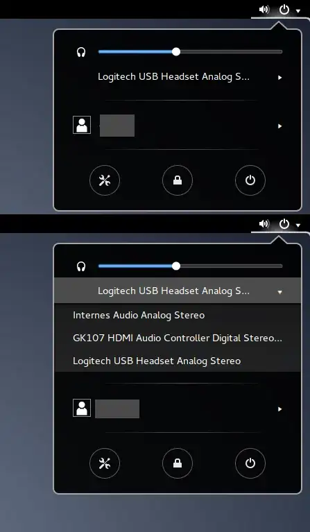

Gnome-Shell Extension Audio-Output-Switcher
the simplest way is just install audio output switcher extension
or you can clone with git directly:
git clone https://github.com/adaxi/audio-output-switcher.git ~/.local/share/gnome-shell/extensions/audio-output-switcher@anduchs
screenshot
This extension adds a little entry to the status-menu that shows the currently selected pulse-audio-output device. Clicking on that will open a submenu with all available output devices and let's you choose which one to use.

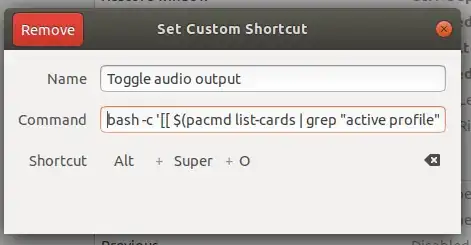

I use almost every day this custom shortcut to toggle between audio outputs:
screenshot
bash -c '[[ $(pacmd list-cards | grep "active profile" | \
cut -d " " -f 3-) = "<output:hdmi-stereo-extra1+input:analog-stereo>" ]] \
&& pacmd set-card-profile 0 "output:analog-stereo+input:analog-stereo" \
|| pacmd set-card-profile 0 "output:hdmi-stereo-extra1+input:analog-stereo"'
