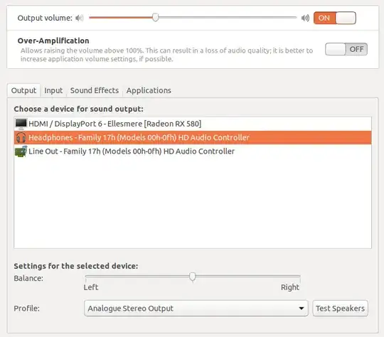

The below instruction will separate Line Out and Headphones (mine is actually a headset with mic) in the Ubuntu 18.04 Sound Settings (Volume Settings). You can swap the output device using by clicking on it in Sound Settings and individually set the volume for each.

You should now see separate options for speakers and headphones in sound settings.
