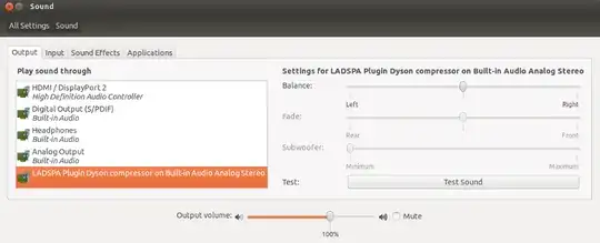

To obtain a fairly normalized sound output level independent of the input level we may use a LADSPA-plugin to filter the sound output through PulseAudio.
As a minimum, we need a compressor plugin such as the dysonCompressor from the swh-plugins which need to be installed if not yet present.
After having found out the name of our default sink with
pacmd list-sinks
and the exact name of the plugin as it is stored in /usr/lib/ladspa/ (with my system here dyson_compress_1403) we can issue the following command
pacmd load-module module-ladspa-sink sink_name=ladspa_sink master=<alsa_output> plugin=dyson_compress_1403 label=dysonCompress control=0,1,0.5,0.99
Replace <alsa_output> with the exact name of the output sink (in my system this was alsa_output.pci-0000_00_14.2.analog-stereo).
The compressed output can now be heard on the newly created output sink ladspa_sink accessible from the Sound Settings menu.
