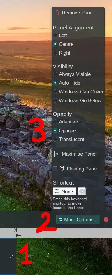

I have KDE Plasma 5.28.8 and I see now there is now an option to choose between "Adaptive, Opaque and Translucent"
Go to the panel and right-click to get into edit mode.
Then select More Options, and choose "Opaque".
Screenshot of the panel editor
You will need to repeat this for each panel.
(As you can see from the screenshot, the panel edit menus themselves are still transparent, but I can live with that, as long as the panel itself is non-transparent.)
