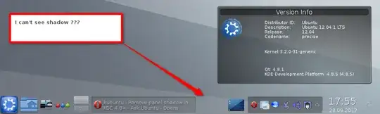

I can't see panel shadows.

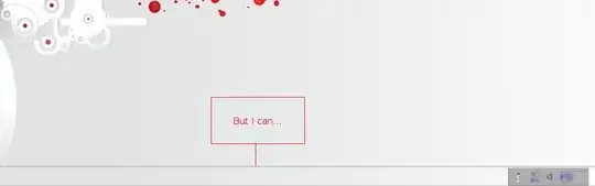

Take 2

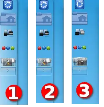

The original Air theme (1), Transparent (2), Without the shadow (3).
1) Copying the default plasma theme (Air) from the /usr/share/kde4/apps/desktoptheme/default to the ~/.kde/share/apps/desktoptheme/transparent .
2) Editing the ~/.kde/share/apps/desktoptheme/transparent/metadata.desktop. Changing the theme name to the Transparent

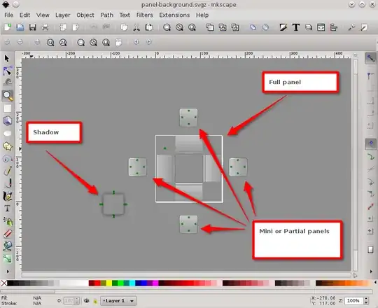

3) Editing the ~/.kde/share/apps/desktoptheme/transparent/translucent/widgets/panel-background.svgz

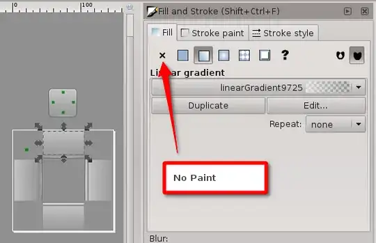

4) Changing the Fill from the Linear gradient to the No Paint. The result is a transparent panel with the shadow (2)
5) Removing the shadow. Picking the shadow elements and deleting them. The result is a transparent panel without the shadow (3)
6) If you want to use the partial/mini panel edit the mini elements. Change the Fill to the No Paint.
The panel svg image is a bit bare....
