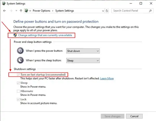

Performing a full shutdown of Windows will allow the drives to be fully mounted by Ubuntu. This can be accomplished by holding the SHIFT key as you press the "Shut down" button on the "Power" menu.

39
If it happens in case of dual booting with Windows 10, you need to uncheck turn on fast startup in Control Panel --> Power Options --> Choose what the power buttons do and then shutdown, not reboot. Once it's done properly you'll be able to access the NTFS partitions normally with read/write permissions.
This happens due to the Windows 10 update resets it to the default fast startup which is a form of hibernation.
