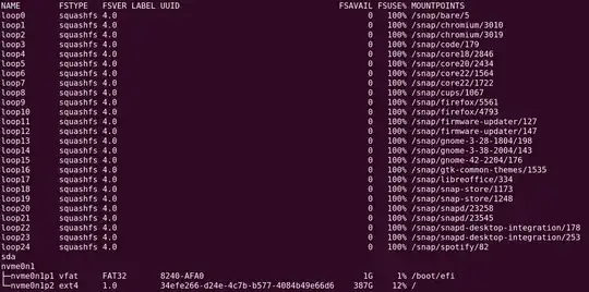

Output of lsblk -f is this, sda is the external drive in question:

Update2: I think this case is different from the mentioned question and from the one karel writes below because of the following: Let's call state0 if the disk has NTFS file system and Ubuntu24 cannot mount, state1 when Ubuntu24 can read and write the disk without problem. First I tried to reach state1 from state0 as well as these questions. But along the path somehow I got to state(-1), where he file system is not NTFS anymore and the disk data is unaccessible in every OS. Now I want just to understand what happened and go back to state0 and recover my lost data, it's okay if just on Windows like before.

Should I run chkdsk on Windows or use ddrescue to try saving data? I'm afraid of making problems worse with doing anything.

I believe using ddrescue then other tools to recover files is your best option now. Ubuntu Datarecovery documentation has some good advice. I've successfully used ddrescue images in the past to recover (most) files from damaged NTFS drives in the past. If this doesn't help you could try some of the $$$ disk rescue programs on Windows. I don't have any experience using these, and depending on the type of damage they may not be any better than the free tools available on Ubuntu, but are likely easier to use. The key is to get the ddrescue image on another disk in case your external drive has failing hardware vs. a software glitch.
