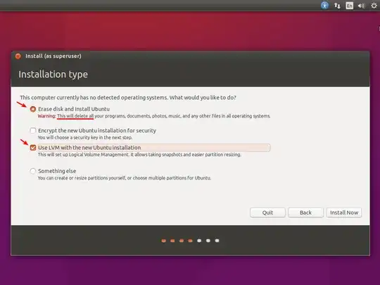

Here's what I did.I playfully chose LVM (without knowing what it is) and clicked 'next'which has now corrupted the MBR or the Partition table (all these are wild guesses,I really don't know what has gone wrong).

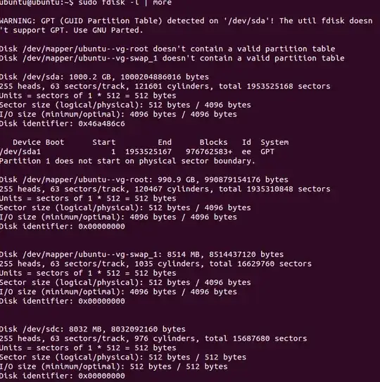

My Laptop has got a 1 TB HDD and this is what fdisk -l | moreoutputs. enter image description here

If this is what you selected, then you wiped the entire HDD.
You must now reinstall Windows 10.

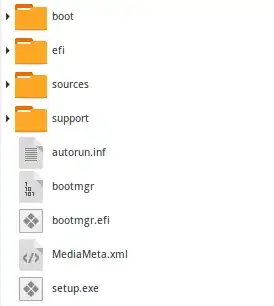

  5. Extract the ISO (I don't know how you do that in a live distro) in the root of that partition so that you will get Windows folders like this:
  1. Go to efi folder, then boot and checck if you have a bootx64.efi file there.
  2. Restart PC, remove USB flashdrive and set it to boot from HDD. It may start Windows installation.
  3. When formatting HDD for Windows, do not format the partition at the end that holds installation files! You will do that from Windows Disk Management after the installation is completed.
