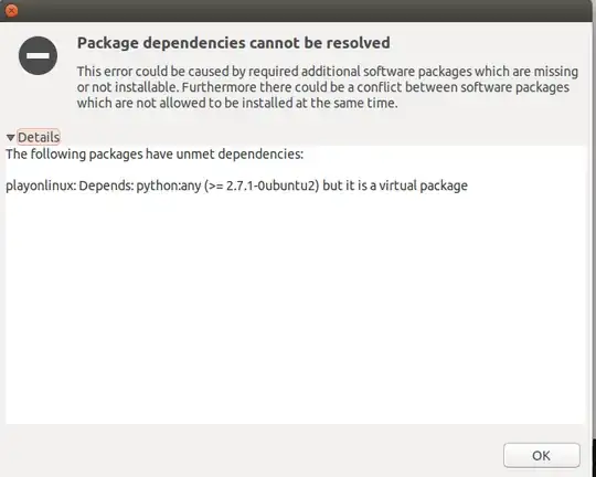

As i mention in Q. I have wine 1.6 and my winetricks can run with this wine
$wine --version
$wine-1.6.2
$sudo apt-get install playonlinux
Reading package lists... Done
Building dependency tree
Some packages could not be installed. This may mean that you have
requested an impossible situation or if you are using the unstable
distribution that some required packages have not yet been created
or been moved out of Incoming.
The following information may help to resolve the situation:
The following packages have unmet dependencies: playonlinux : Depends: wine or wine-unstable but it is not installable E: Unable to correct problems, you have held broken packages.
via Ubuntu Software Center enter image description here
apt-cache policy wine
wine:
  Installed: (none)
  Candidate: 1:1.6.2-0ubuntu4
  Version table:
     1:1.6.2-0ubuntu4 0
        500 http://archive.ubuntu.com/ubuntu/ trusty/universe amd64 Packages
sudo apt-get install wine1.6
The following packages have unmet dependencies: wine1.6 : Depends: wine1.6-i386 (= 1:1.6.2-0ubuntu4) E: Unable to correct problems, you have held broken packages.
How can i fix this problem?.

Install wine with the command:
then install playonlinux by the command,
