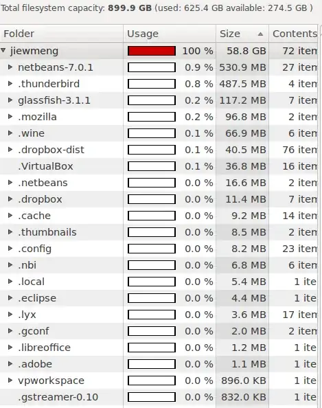

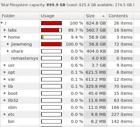

Just today, my Ubuntu 11.04 started prompting me that my HDD is full ... I know I am filling up my HDD fast, but its the storage partition I expect to be filling up not my 60+GB OS Partition. So I did a Disk Usage Analysis and got the below:
/labs is actually the Storage partition
First, my home folder /home/jiewmeng is said to use 58.8GB? but the biggest few files, don't appear to sum up to that? Counting quickly, it looks like ~1.5GB only?

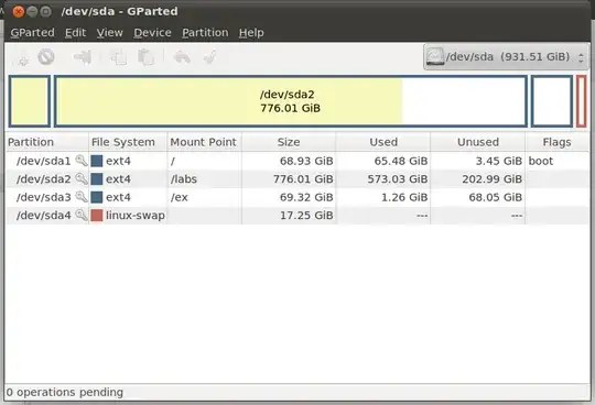

Looking at the 2nd image, my HDD doesn't seem to be all that full at all? Is it a mistake?

You may have hidden directories accumulating large files. The first yellow block in the gparted window shows that the root partition (/dev/sda1) is almost full.

My home folder /home/jiewmeng is said to use 58.8GB? but the biggest few files, don't appear to sum up to that? Counting quickly, it looks like ~1.5GB only?
The output of Disk Usage Analyser only shows directories. If your home directory is full of very large files, that will be included in the usage number of the home directory, but those large files won't get separate rows in the displayed table. This is probably what is happening in your case.
You have three partitions on your hard drive (not counting the swap partition), as shown by GParted. Your home directory is included in the partition /dev/sda1 mounted at /, since it isn't in its own partition. /dev/sda1 only has 3.45 GiB free space. Some of this free space (5%) is reserved for the root user by default. If you subtract that, you get what is known as the "available space", which is 4KiB according to the output of df. To double-check, run System Monitor and open the File Systems tab, you'll be able to compare the free space and the available space of each partition at once.
So, yes, the first partition is very full.
If I were you, I would boot a live CD of Ubuntu, make a backup of my data, shrink the /dev/sda2 partition, and grow the /dev/sda1 partition using GParted.
