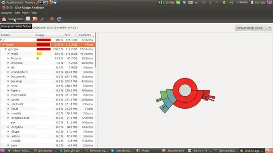

I have problems understanding my disk space usage. I am using Ubuntu 12.04. I am recently going low on disk space and I cannot understand why. Here is the result of du (only largest folders).

What I don't understand is where the 304G used come from. The result of du does not sum up to that amount. That make me difficult to free space (as you see I have only 1.4G available). What am I missing here?
I add an image of Disk Usage Analyzer. The point is that the first 10 largest folders sum up to less than 165G. But still my home folder uses 312G.

To get the largest files in a directory, including hidden dotfiles, try running:
du -h .* | sort -h
