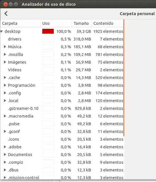

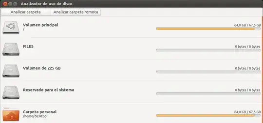

I have installed Ubuntu 12.10 64-bits and it worked perfectly (during days), until now. Suddenly several error messages coming from anywhere tell me that I have no free space on the disk. And now the Disk Usage Analyzer application show me this:
DUA-0
I have open this application one day before and the quota of that partition was 2%. As if it had ridiculously increased in one day from 1G to 64G. You can see that this is wrong with this image:
DUA-1
