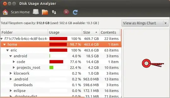

Here's is the evidence that something is amiss. When I run du (with and without --apparent-size) or the visual Disk Usage Analyzer, I show that I'm really only using about 35GB or so. 98.7% of the used space is in /home/eric, but du doesn't add up to that. The discrepancy is between /home/eric and /home/eric/android

The image you posted is telling you where the space is being used: /home/eric. It seems you have a very large file in there hogging all the space, or possibly a large number of smaller files. Open your home directory, make sure to show hidden files (Ctrl+H in Nautilus ), and sort by file size.
