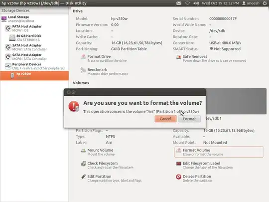

175

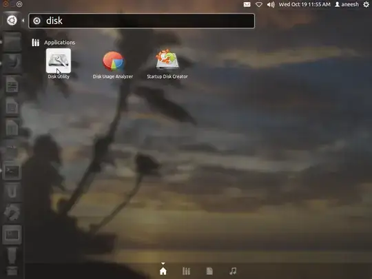

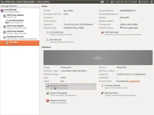

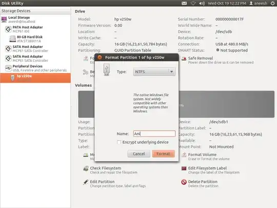

You can use the disk utility(installed by default) to format the drive. There is an option 'format volume' select that option.

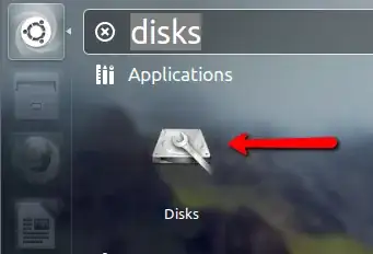

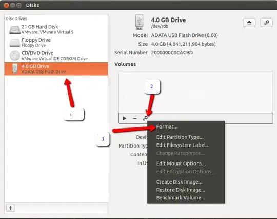

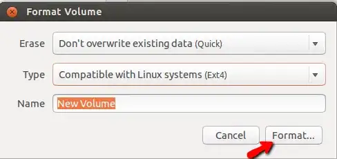

Formatting a USB drive (Updated for Ubuntu 13.04)
Type Disks in Dash
Click on the little gears to open the sub menu as seen in the image below, and click on Format.
Once the format window appear, choose the way you want to erase, The type of format, and volume name if you need, and then click on format as shown in the image below.

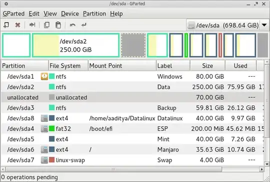

You can try the GParted program for all your partitioning tasks.
You could search for it in the Ubuntu Software Centre or you could type this in the terminal:
sudo apt-get install gparted
With GParted you can format your External HDD partition to ext4, but the partition should be unmounted.
Select your external hard drive from the top right corner (it would be marked as /dev/sdb most probably), then right click on the partition and format.
GParted
After formatting, click on the accept button (it's in the middle of the menu bar) to save the changes.
Now you would have successfully formatted your external drive to ext4, and it would show up in GParted as a single ext4 partition.
