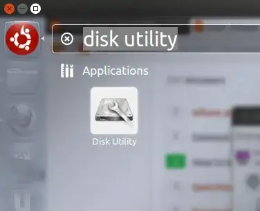

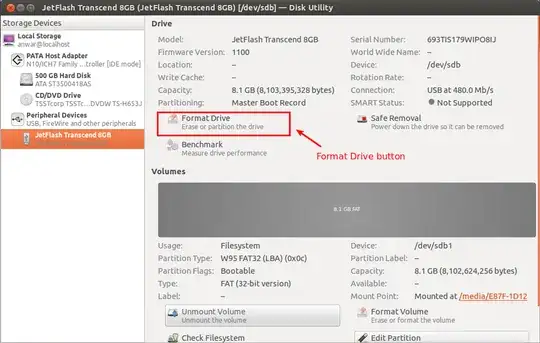

Using Disk-utility
  1. Press Super key and Type "Disk utility" in it.

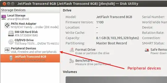

  2. In the Disk utility window, Select the USB drive in the "Peripheral devices" section.
  3. You may need to unmount the drive first.

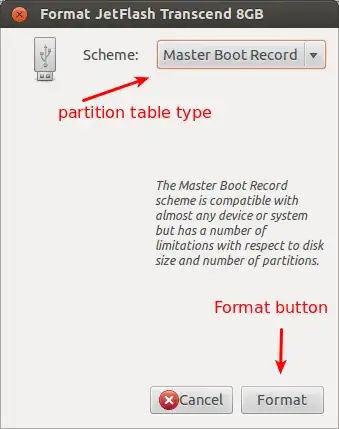

  4. Then click on the "format drive" button
  5. Select partition table type from the new window. Select "Master boot record".

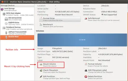

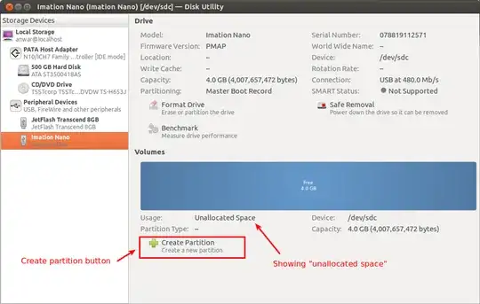

  6. After you created the new partition table. The disk utility window will look like this

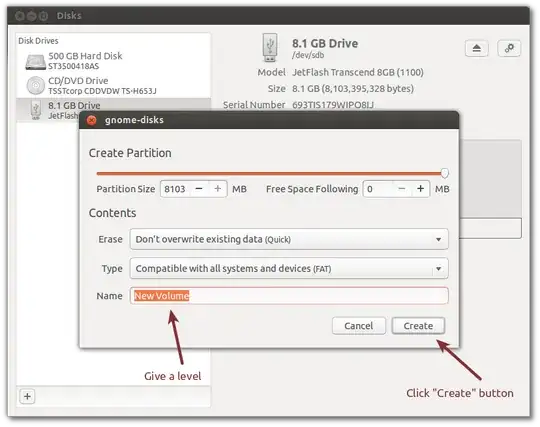

    Click on "Create new partition" button.
  7. Select "Partition type" and optionally type a name for the partition.
  8. The partition will be created within 4-5 seconds and you will have a clean USB disk afterwards.

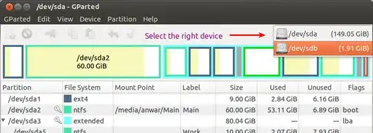

Using Gparted

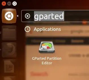

  1. First you need to install gparted, if you haven't done so yet. You can install it by clicking this link : gparted Install gparted or using this command in a terminal
    sudo apt-get install gparted
  2. Then open gparted by typing "gparted" in the dash. To open dash, press Super key which also known as "Windows" key.
    opening gparted from dash
  3. Then select the USB device from the drop down menu in right. It should be like /dev/sdb, /dev/sdc etc. Please take special care for not to select /dev/sda, because it is the device your OS is installed. You should only select it, if you know what are you doing.

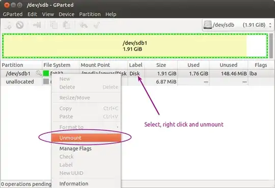

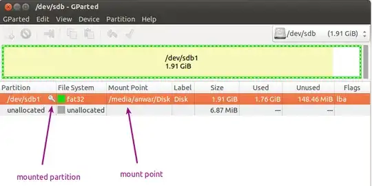

  4. After selecting the USB device, (which is in my system, /dev/sdb) , see whether any of it's partition is mounted. You can see a key icon in the mounted partition entry and the mount point of that partition.
    mounted partitons
    Unmount any partition mounted partition on that device. To unmount, select the partition → Right click → Select unmount from the menu.

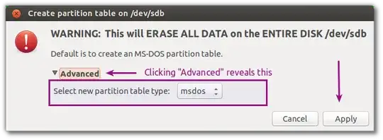

  5. Then going to gparted menu → Devices → select Create partition table to overwrite and create a new partition table on the selected device.
  6. A new window will be shown Warning you to the action going to be done. The default partition type is "msdos" and I strong suggest you not to change it, if you do not know. Also check another time that, you indeed selected the right device. Then Click Apply button.
    Warning
    After clicking Apply button, the device will be absolutely empty. No partition and no data.

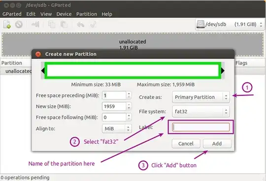

  7. Then select the unallocated space → Right Click → Select new to create a new partition.
    new partition
    In the create new partition dialog box, select Create as "primary", File system as "fat32" and click on the Add button. Optionally, you can also give a name to this partition.
    Create file system

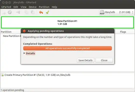

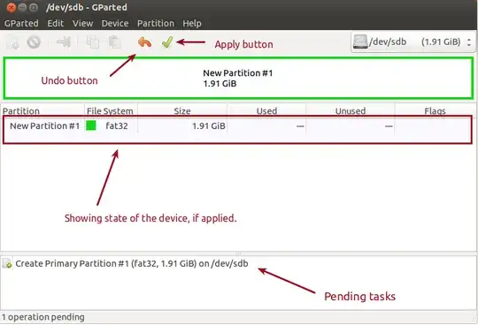

  8. After you click Add button, gparted will show you a preview of the device if you apply the changes. There will be a light green tick mark icon in the toolbar. You need to click that icon to apply change. There is also an Undo button, you can use it, if something goes wrong at any step.
    Apply changes
    After applying the changes, gparted will show you a message saying "All operations have been completed successfully".
    success message
Now you are done with it.

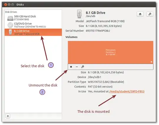

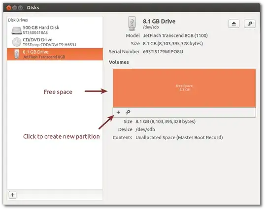

Using new Disk-utility (12.10)
Ubuntu 12.10 is now equipped with a new Disk utility. It uses new udisks2 program as backend.
  1. First open the new Disk-Utility by typing "Disks" in the Dash. Bring the dash by pressing Super key
  2. After opening the Disks (former disk-utility) program. Do these
    1. Select the externel disk
    2. Unmount the disk if it is already mounted.

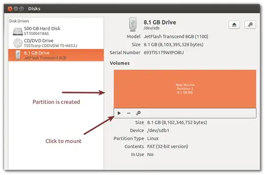

  3. Then select the partition and delete it by pressing the "Stop" play icon.
    Repeat this step if you have more than one partition on the disk until all partition has been deleted.

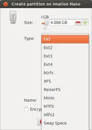

  4. After all partition has been deleted, the disk will now only contain Free space. You can now create a partition by clicking the small + icon.
  5. Select the type as "FAT", give a label and push the "Create" button to create a partition.
  6. Your disk is now containing a partition. You can mount the partition by pressing the "Play" icon. You can directly browse the location of the mounted drive by clicking the link with label "In use, Yes"
You're done.
