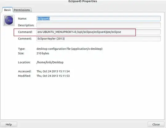

This is the same workaround: If you have a launcher on the desktop, you can insert this into the "Ccommand" line of the Launcher's properties page:
env UBUNTU_MENUPROXY=0 /opt/eclipse/eclipse43jee/eclipse
Like this:
Screenshot
