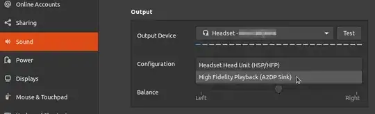

Go into sound settings, then see what the SHB4000 is using. If it uses HSP/HFP change to A2DP.
screenshot

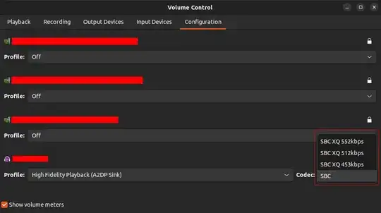

I had the same issue, using Ubuntu 22.04.1 LTS
Whenever I connected my wireless earbuds I got static distorted sound
so I installed PulseAudio
sudo apt install pavucontrol
opened it and changed the Codec of my connected device
that seemed to do the trick!
