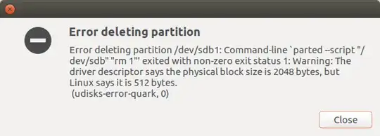

Have a USB drive that used to be bootable Ubuntu install. I want to repurpose it now but can't delete any of the partitions.

use the command line to format this partition using the following steps (of course by root user):
root user):
$ fdisk /dev/sdb
This will log in to the a disk management in console. type m for help (manual). Continue deleting the partitions using d and write it to the table using w.
All the required information are available here.
