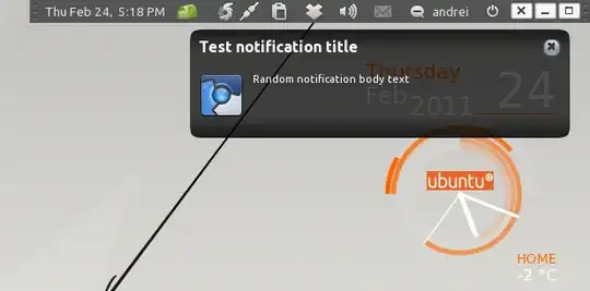

There is a way you can get notifications with a close button.
From Webupd8's Article
First install Avant Window Navigator from the software center and add the "Notification Daemon" to the dock.
Now press Alt + F2 and paste gconf-editor
Then navigate to apps > awn-applet-notification-daemon (this is for the latest AWN from the AWN trunk PPA, it may be apps > avant-window-navigator > awn-applet-notification-daemon on older versions of Avant Window Navigator). Clicking a key will display its description at the bottom so you'll know how to tweak it. The most important key is: "kill_standard_daemon" - make sure this is enabled or else the AWN notifications won't work.
For instance, "override_x" is the horizontal position on the screen (for which I've used "1900" because my screen width is 1920 and I want the notifications to be displayed on the right), "override_y" is the vertical position (for which I've used "30" so the notification dialog is displayed in the top right corner) and "gradient_factor" is the transparency. That should be enough to get you started.
To customize the colors, uncheck the "use_theme" box, then specify a "text_colour" and "bg_colour" and so on.
An important feature you may want to turn on is "show_icon". This will display an icon on your Avant Window Navigator dock which you can then click to temporarily disable/enable the notifications.
Lincity
  • 25,749
Instead of using avant window navigator, you could also do this (only tested on Lucid):
Install xfce4-notifyd from the software center and press Alt + F2 and paste killall notify-osd
This switches to XFCE's notify daemon, which looks a lot like the default one, only a close button appears when you hover over it.
