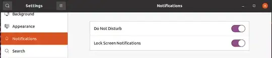

What I could do is disable notifications globally with Do Not Disturb, and it effectively worked for my case, but that applies to any notification.
