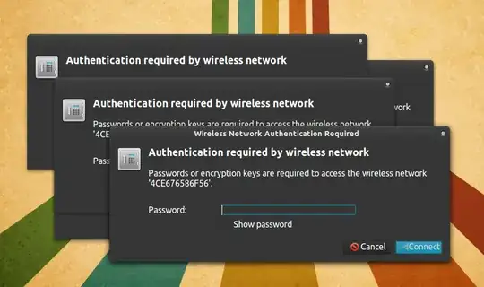

and not the notifications but this program I think it is apport but not sure that is responsible for the "wireless authentication required" windows shown below:
Please tell me how I can turn these off. When I go to sleep and leave wireless on, I get HUNDREDS of these . Hundreds!!! And then I have to close each one individually which takes sometimes several minutes of clicking through them. Sometimes My computer wont even wake from sleep due to the amount of ram consumed by the hundreds of these windows.
I often forget to turn my wireless off before I sleep. I try to do it and that will negate this problem but I shouldn't have to make a conscious decision to do that every time. I want to leave my wireless on and I don't want to get these windows.
AT THE VERY LEAST, You only need to get one window asking for a password from ONE network right? BUT I get hundreds of these windows asking for a password for THE SAME NETWORKS!!!!!
help!
Specifically I would like to fix this problem while allowing me to leave my wireless connection on while I sleep and not have to put my computer into hibernation.
As @devav2 said this is a bug. I found it here
Workaround for not nm-applet asking for the keyring all the time is to go to NetworkManager (nm-connection-editor) & remove wireless networks that are not currently in use or those wireless networks one doesn't have access to.
Ok I solved this bug... finally! Delete all the internet connections that you have, even the one you are using. Restart the computer. Now when u start it up again ubuntu will change some of the settings for wireless connection and it will "fix itself". If ubuntu doesnt find your wireless connections, type it in manually by "edit connections".
This solved the bug for me. The idea is that you delete settings that u had in an earlier version of ubuntu, causing the new version of ubuntu to ask for password indefinately. When u delete all the connections the new version gets to find these settings by itself.
It's not a solution to the bug, but the multiple windows can quickly be gotten rid of via the killall nm-applet command in a terminal.
