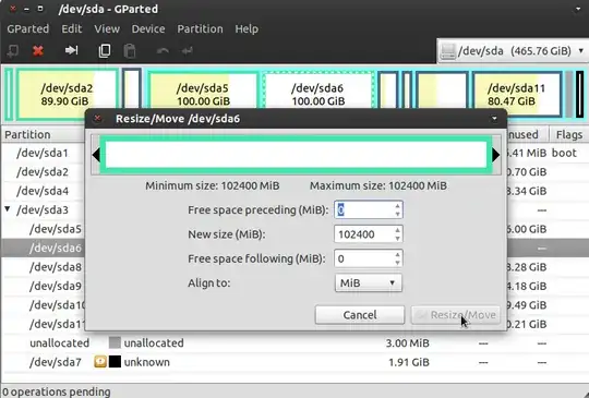

You can use gpartedusc_logo for this. Also installable by sudo apt-get update && sudo apt-get install gparted
To make one big fresh partition (deletes all data on your filesystem):
  • First you'll have to make sure that both the partitions - unallocated space and the other partition to merge are either both logical partitions or both primary partitions. One logical and one primary will not work.
  • After checking and confirming the first step, delete the partition holding a filesystem.
  • Third, the unallocated space is now bigger since you have deleted a partition.
  • Create a partition of required size.
To increase the size of the partition holding data: (Although this is mostly safe, it's always wise to make a backup of your data!)
  • Second, right-click on the partition in question and click resize. Fill in the size as required.
  • Click resize/move and then click Apply all operations
screenshot_gparted
