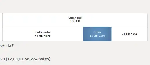

I wish to increase size of my / partition (current size 21 GB), is that possible somehow? I have more free space available, but don’t know how to add it into the existing partition. I have created a new partition (named Extra, size 12 GB) with that free space and would like to either merge it with / or if that’s not possible is there any way to change the mount point. Because the new partition I have created with the free space currently get mounted at /media/Extra and I have to mount it every time I start computer.
Here is the output of sudo fdisk -l

This is the image from the Disk Utility GParted screenshot, 2 ext4 partitions from bottom
Please help me in resolving this issue. Thanks!!

Delete /dev/sda7 (Extra). This should concatenate unallocated space around it and produce a single unallocated block. After that you should be able to increase /dev/sda6 up to plus that space with Resize operation as described here How to merge partitions?
