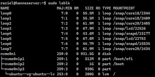

So I've got a problem with a partition in a partition. Disk hierarchy:
Disk hierarchy screenshot
My disk (nvme0n1) is partitioned into 3 parts.
  1. /boot/efi 512M (nvme0n1p1)
  2. /boot 1G (nvme0n1p2)
  3. no name (nvme0n1p3)
nvme0n1p3 has a "subpartition" named ubuntu--vg-ubuntu--lv (200G) which is mounted/used under /. nvme0n1p3 is 930G big, but the Ubuntu partition only 200G. Now my question:
Is there a way to get the remaining 730GB into the ubuntu partition with the terminal, without losing all data?
The Ubuntu partition is ext4, if that's important. I'm using Ubuntu 20.04.

The comment of @Terrance worked.
He pointed out an answer from another question, which worked. I did the following steps from the answer:
raziel@hanneserver:~$ sudo lvextend -l+100%FREE /dev/mapper/ubuntu--vg-ubuntu--lv
  Size of logical volume ubuntu-vg/ubuntu-lv changed from 200.00 GiB (51200 extents) to <930.01 GiB (238082 extents).
  Logical volume ubuntu-vg/ubuntu-lv successfully resized.
raziel@hanneserver:~$ sudo resize2fs /dev/mapper/ubuntu--vg-ubuntu--lv resize2fs 1.45.5 (07-Jan-2020) Filesystem at /dev/mapper/ubuntu--vg-ubuntu--lv is mounted on /; on-line resizing required old_desc_blocks = 25, new_desc_blocks = 117 The filesystem on /dev/mapper/ubuntu--vg-ubuntu--lv is now 243795968 (4k) blocks long.
raziel@hanneserver:~$ df -hPT / Filesystem Type Size Used Avail Use% Mounted on /dev/mapper/ubuntu--vg-ubuntu--lv ext4 915G 181G 696G 21% /
